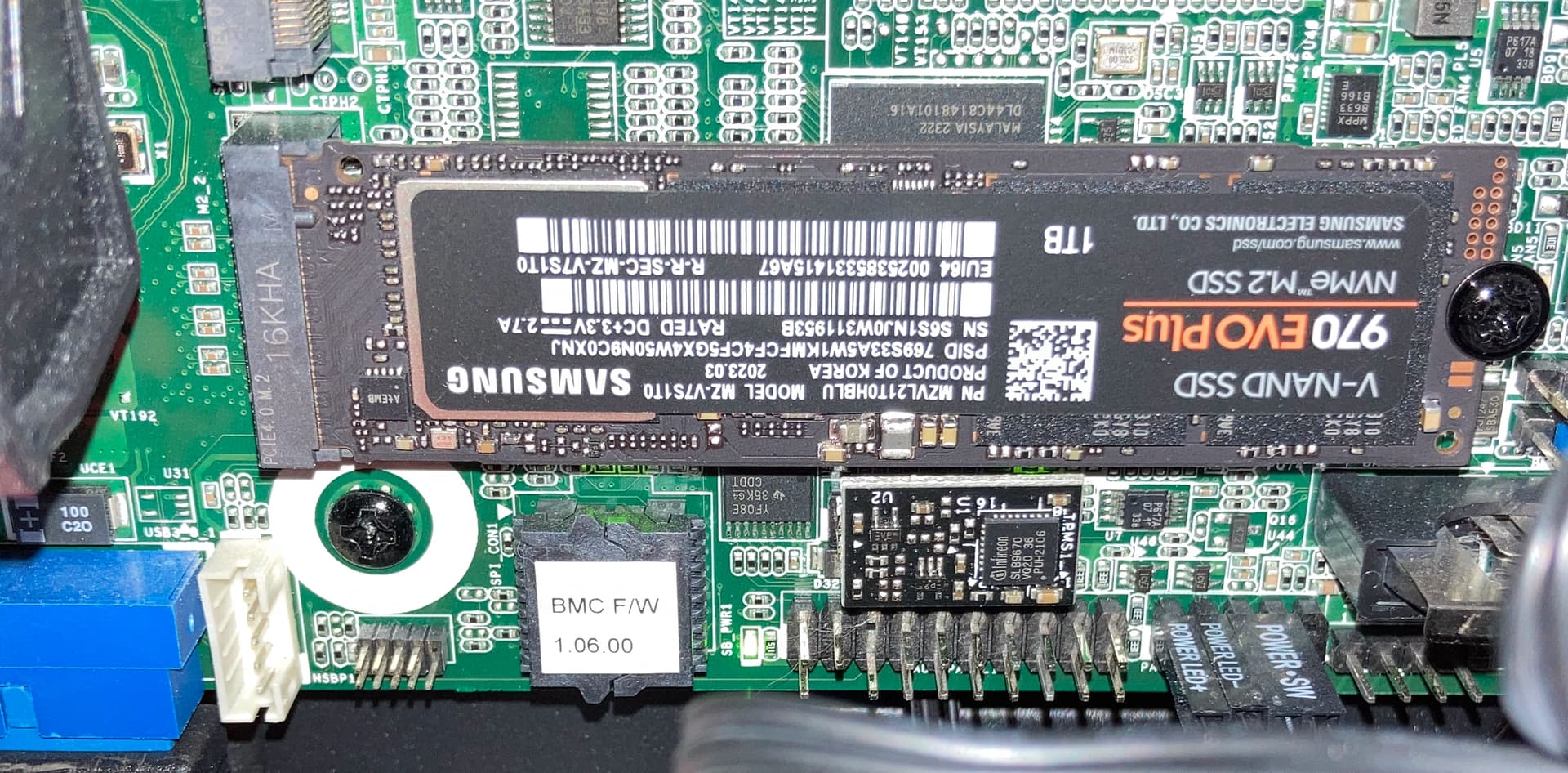

Honestly that is one of the questions towards asrock - why top two slots (most accessible/compatible ones) are only x8 on non-Max altra?
For example it mentions a debug console on port 2203, however in reality it is 2200.
That just changed with the latest beta BMC firmware. It used to be 2203.
My board had 02.05.00 (doesn’t seems to be available on ASRock website) out of the box and it was 2200 there. I’ve verified that before updating to 02.06.00 BETA

The sensors show the BAT at a very low level (0.045 V !!!), but when I removed it and measured it, it was at a nice 3V.
Finally got my ASRock Rack Altra system working, after almost two months!
First, the CPU was dead; either DOA or died by not correctly connecting the 4-pin power connector.
Then, after replacing the CPU, none of my memory modules would be accepted in slots A1-D1. They would work fine in E1-H1. This turned out to be caused by the CPU cooler. See this topic.
Thanks to ASRock Rack tech support for figuring out this was the reason, even without seeing my old cooler. And thanks to other forum members for helping me out. You know who you are.

Just to double check, this is how I have the module installed:
am I … off by one? :roll_eyes:
that was it! Thank you @bexcran !!!
