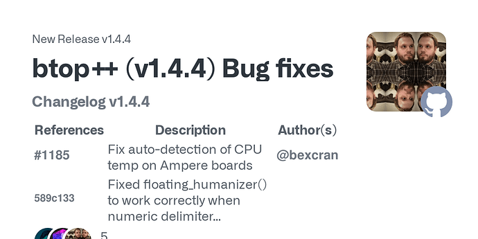

It’s fixed in btop 1.4.4!

Fix auto-detection of CPU temp on Ampere boards by bexcran · Pull Request #1185 · aristocratos/btop · GitHub - pull for the fix in btop.
