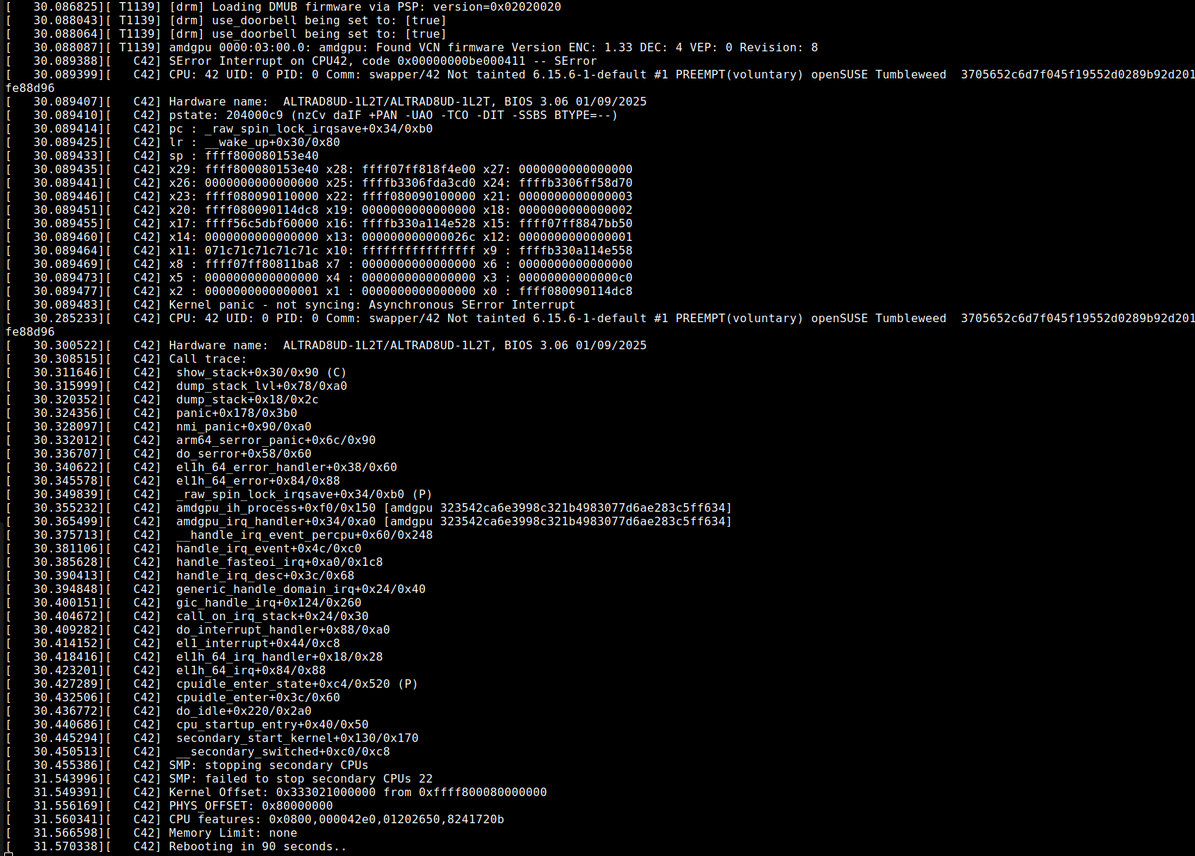

In case anyone else comes across this, I had this same problem with a new RX 6700 XT.
There were actually two problems: first was a panic (see screenshot) that I fixed by enabling Resizable BAR in the UEFI Settings.
Then I got the “*ERROR* KCQ enable failed” error, which I found could be worked around by unplugging the second monitor I’d connected.
