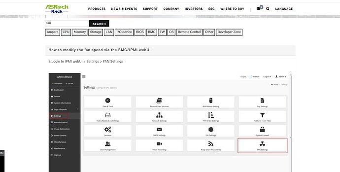

Did ASRock fixed the BMC to have a control from the interface?
I want to keep the automatic mode, but ramp up the starting point of chasse fans which are turning very slow. if I use the ipmitool I am changing all of the fans to manual mode which I dont want to do.
I dont remember what I did, but at one point to saw the fan interface control. I cant figure out what I did or which setting I changed.
